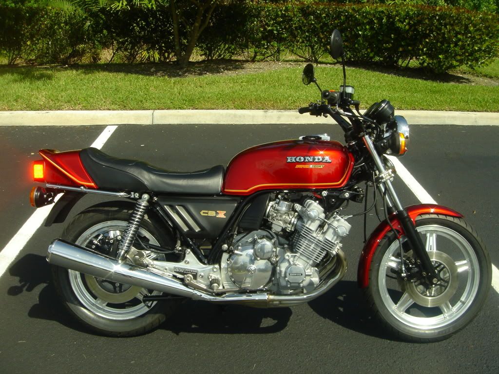

OMG I am in Heaven! When you do a complete restoration the rewards are so great. This bike is such a dream. I have to go ride! Thank you all for your support and patients! Chip
And that is camera flash on the tail, not a chip in the paint!!

It's always nice to see an original looking CBX coming back together again! Why does the bike have a km/h speedometer?

Oh, and yer bike looks the business !
