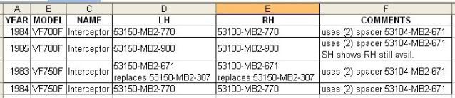

According to fork seal supplier (Shindy), there are only two other Honda bikes that use 39mm fork seals that also have non-tube type handle bars (besides the 1981 & 1982 CBX).
Based on this, and a check of ServiceHonda parts list, here's what we have for handlebar part numbers: (I'm assuming these are all based on USA market bikes only)
Anyone know if there are any significant physical differences in the various handlebar part numbers?
