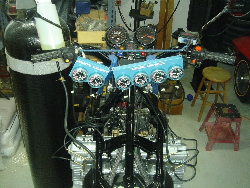

Thank you for the posts, still running at high rpm's.
I removed the carbs and checked the slides. They were smooth as I was able to push them each up with my finger and they returned nicely. Also while on the bench, I checked the throttle plate where the cable attach. They had quite a bit of spring snap back and all plates returned closed, again nicely. I didn't close the position of the throttle plates any further as they were closed down nearly completely, but not just showing one hole. Perhaps a bit more here and there. I really couldn't see anything wrong. SO, I put them back on and same problem. I bought six vacuum type gauges to sync the carbs. I had mercury type but chose to upgrade. I broke the sync nuts loose and backed out the screws about a 1/4 turn, started the bike and same thing. Hung at 4,000. So I kept backing them out without any change..
I am at a loss. The bike starts nice, only has 5300 kilometers on it.. So I am thinking it is not an advance issue??
I will crack the slide cans loose as an effort to fix, but don't think that will help as the slides moved freely when on the bench. The cables are new and work well. I think it could be a little better but am confident they allow the plates to return to the closed position.
Absent any other suggestions I will take the carbs off again, bench sync them, and seek to ensure the plates are centered and returning completely. ( I am confident all is well here but I am running out of ideas).
The bike has new intake boots. Pilot jets set at 1 1/2 for now..

I think you are vastly underestimating the importance of EXACT positioning of the throttle plates. "A bit more here and there" won't cut it. And your method of backing the sync screws off "about 1/4 turn" is the wrong approach. The sync screws move the throttle plates directly and each bank is connected such that each one effects the others. I'm thinking you made matters worse. Please do remove them again and bench sync them, but you need to be absolutely sure about how to do that. From the look of the gauges, #6 is hanging 4 & 5 open also.

I will take them off again this evening when I get home.. The engine was off when I took the photo so the gauges are not reflective of anything. When checking the plates, to ensure they are perfectly centered, is there any perferred method? I can't imagine they are hanging up but have to look at everything once again while I have them off.

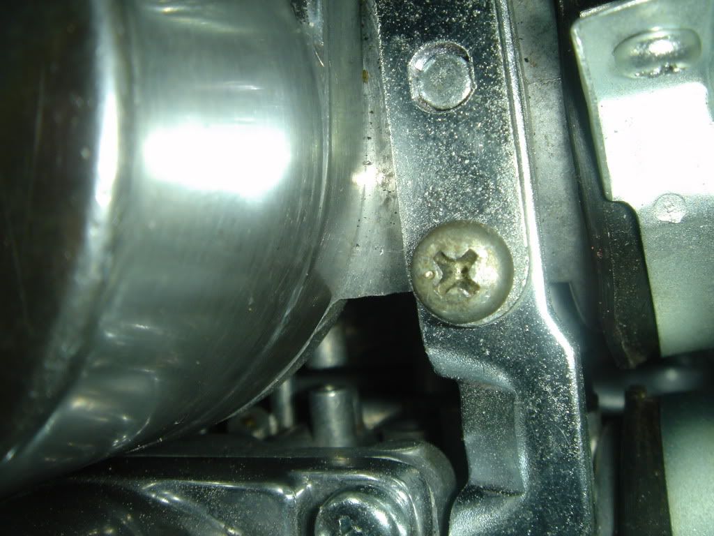

Well I bench snyc'ed the carbs tonight. I thought I was going to be smiling by the end of the night but same problem. Yes, adjusting them on the bike was doing it blind, and they were well off when I put them on the bench. This lead me to think my problem was solved. Unfortunately, it was not. Photos show before. #4 was open quite a bit more than the others. This was a result of trying to adjust them on the bike while running.. One thing for sure, they are dialed in right now.. Throttle plates perfectly aligned, all plates just barely showing the first hole. Engine still racing. Throttle cables move freely, and snap back/return to closed position. Slides are returning to the bottom. Cans are not hanging up the slides. :(

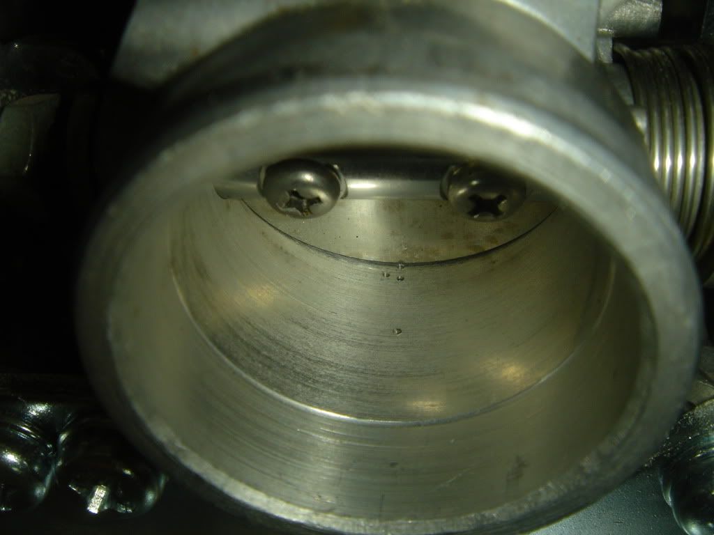

Is this the passage you are referring to? Of course I am referring to the passage from the bottom up. Disregard the writing in the photo.
